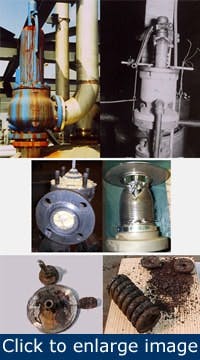

Figure 1. Various failure modes. Clockwise from top left: plugged drain, run beyond failure, ruptured bellows, corroded springs and washers, component corrosion, clogged with product.
Troubleshooting begins with the piping configuration, physical orientation and application data such as system pressure, temperature and physical properties of the contained fluid. You’ll need to address installation issues such as stress from vessel and piping expansion and unsupported discharge lines. In addition, improper valve application can result in mechanical damage from elevated temperature, backpressure, material incompatibility or incorrect pressure setting (Figure 1).
Installation problems often result in PRV operational malfunction. Trained and qualified maintenance personnel might recognize and correct such issues. Proper PRV installation is the first step in preventive maintenance. However, an improper installation that causes a PRV failure to shut down the system also causes an unscheduled emergency repair. While installation problems are outside the scope of the typical PRV repair, conscientious PRV repair shops will keep the user informed. Failure to correct installation problems will result in repeated PRV malfunctions, thereby shortening the PRV’s life expectancy and raising the cost of unscheduled downtime, additional repairs, spare parts and possibly fines for fugitive emissions.
