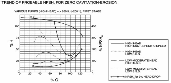

Figure 2. Pump manufacturers usually plot only the NPSHR (subscript R) trend associated with the lowermost curve. At that time a head drop or pressure fluctuation of 3% exists at BEP flow. (Source: “The Most Persistent Pump-Application Problems for Petroleum and Power Engineers,” by Irving Taylor)
Taylor suggested a demarcation line between low and high suction specific speeds (Nss numbers) at somewhere between 8,000 and 12,000. His data are supported by surveys taken after 1977 at Amoco in Texas City, Texas, by Nelson and Jerry Hallam; there also were other plant locations which pointed to suction-specific speeds of 9,000 or 9,500 as Nss numbers that deserve attention. Many pumps with Nss numbers higher than approximately 9,500 will degrade when being operated at flow rates much lower or higher than BEP. By how much the life expectancy or repair-free operating time of these pumps will be reduced is speculative, at best. Whether these life reductions will amount to 10% off normal or 60% off normal is the subject of much debate and requires reviews on a pump-specific basis.
It reminds us of other rules of thumb. We consider automobile tires unserviceable whenever less than 1/32 in. of tread is left. While it may be possible to operate tires with absolutely no tread left on the carcass, it would be risky to use bald tires on a vacation trip with a wife, four kids, and a dog. Traveling at 75 mph on roads full of potholes would increase the risk exponentially. No researcher has quantified it, but common sense tells the story.
So, while no rigorous Nss value exists, cautious reliability professionals observe safe margins. Many users choose Nss = 9,500 as the limit for flows away from BEP. There are, however, some pumps, including certain high-speed Sundyne designs, that will operate quite well with Nss values higher than 9,500. But these are special cases, pumps with relatively low pump specific speeds (Figure 3). Even so, a close pump-user-to-pump-manufacturer relationship is needed to shed light on applicable long-term experience with these pumps.
