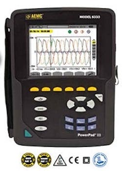

CAS DataLoggers and AEMC introduce the PowerPad III Model 8333, a compact and shock-resistant three-phase power quality analyzer.
CAS DataLoggers and AEMC introduce the PowerPad III Model 8333, a compact and shock-resistant three-phase power quality analyzer. It enables technicians and engineers to measure and carry out diagnostics and power quality work on single- or three-phase networks. Three current and four voltage input terminals are provided, and the device is IEC 61000-4-30 Class B and safety-rated to 600V CAT IV.
The new Model 8333 has memory available for storing trend data, alarms, transients, and snapshot data. The data logger is capable of storing up to 12 screen snapshots, up to 51 captured transients that contain four cycles for each active input, and 4,000 alarm events from up to 10 different parameters. Users can record trend data for days, weeks or even months.The data logger is part of a cost-effective kit which includes three MN193 current probes, four black 10 ft voltage leads, four black alligator clips, twelve color-coded input ID markers, NiMH battery, 110/240V power adapter, USB stick, user manual, and free configuration software.
