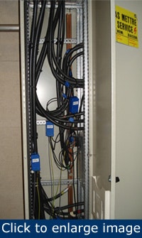

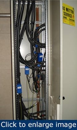

A traditional cabled solution was initially considered, but this proved too difficult and expensive to install for such a short period. There were few plug-and-play measurement solutions available, and the only realistic candidate that emerged was LEM’s Wi-LEM, wireless local energy meter. Wi-LEM’s energy meter nodes are current transducers that feature split cores; they can be clamped around a conductor with no need to disconnect anything for the purposes of installing continuous-loop sensors or in-line current sensors. They gave Inergy the freedom to install the measurement node at the most convenient access point in each power cabinet and required no downtime. The systems’ measurement nodes exceed the demands of the IEC 62053-21 standard for accuracy in energy measurements, achieving 1% accuracy or better.
The LEM wireless energy monitors are portable enough for short-term projects, and a mesh-network configuration can produce points of redundancy that are self-organizing. Source: LEM
The wireless part of the Wi-LEM designation refers to its transmission of data by a wireless mesh network. Wireless operation means no cabling is required in any of the temporary deployments, and the mesh network between measurement nodes and the central data collection point is self-organizing. Cable-free installation does not mean that the system can only be used for temporary installations. Many users will want to follow up a detailed energy-use survey by installing long-term monitors at key nodes to ensure that savings are maintained, and that wasteful usage patterns do not re-establish themselves. In keeping with the latest practices in factory-data-collection system installation, robust wireless mesh networking is also ideal for long-term use. “The system is really fast and straightforward to install, and the mobile solution was important for us,” says Joseph Brossard, Inergy’s utilities and energy saving leader, who also is one of the managers of the INeco project.
In September 2009, the first Wi-LEM temporary network of 40 measurement points was deployed in the Pfastatt facility. The Wi-LEM was installed using a three-phase delta configuration with a measurement range of up to 2,000 A. These transducer nodes use LEM’s Rogowski coils, which feature a perfect loop technology with no discontinuity coil clasp. Measurement frequency for this exercise was set at 240 current values per day for the three weeks, yielding a substantial volume of data — more than 200,000 instantaneous current values. The Inergy team then designed a strategy to extract the maximum information and value from that data set. A first, precautionary step was to apply a quick “sanity check” on the data. The cumulative current measurements converted to power consumed ought to correspond to the amount billed by the utility supplier. The figures agreed within 3%. Reassured the data was sound, the team went on to the analysis phase of the project.
