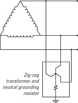

    Figure 4. In a delta-connected system a zig-zag transformer is used to create an artificial neutral, which is then connected to ground through the neutral grounding resistor.

    In an HRG system, the neutral point of the wye transformer connects to ground through a high-value neutral grounding resistor (Figure 3), which normally carries little or no current. An ungrouded system with a delta-connected transformer uses a zig-zag transformer to produce an artificial neutral, which is then connected to ground through the NGR (Figure 4). This transformer carries very little current, so it need not be large or expensive.

    Install the NGR between earth ground and the neutral point of the transformer — the center of the wye (if converting a grounded system) or the center of the zig-zag transformer (if converting an ungrounded system). Install an HRG relay in series with the NGR. This unit can be a neutral-grounding monitor, which measures the current and voltage in the neutral-to-ground connection and the continuity of the NGR, or a resistance grounded relay, which detects a ground fault and monitors the neutral-to-ground connection, and includes a pulsing contactor for use in locating ground faults.
