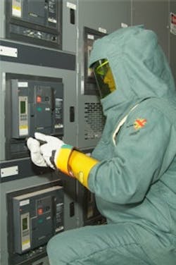

Ensure there is adequate personal protective clothing and equipment on hand. Employees working in areas where there are potential electrical hazards shall be provided with electrical protective equipment that is appropriate for the specific parts of the body to be protected and for the work to be performed. This can include fire-resistant shirt, pants or coveralls, or a multi-layer flash suit.
