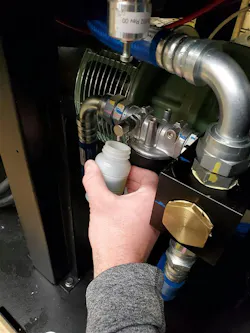

Sampling ensures fluid health reliability
Most compressors do not operate in controlled environments. OEM compressor fluids are engineered to deliver reliable performance in a variety of operating conditions. Fluid performance is affected by several factors including duty cycles, industries, plant conditions, applications, operating hours and other conditions. Preventive maintenance programs including oil sampling can serve as an early warning system. An oil sample report can tell you if your lubricant is still doing its job or if contaminants and oxidation are threatening your compressor.
Oil sampling typically measures the following:
  • Viscosity changes indicate thermal breakdown or contamination.
  • Oxidation and acidity reflect fluid degradation over time.
  • Wear metals point to internal wear of critical components.
  • Water content is a sign of moisture ingress or condensation buildup.
Catching these issues early can help prevent unwanted compressor downtime. For example, if you ignore recurring high acid warnings in oil sample reports, weeks later, the compressor could seize during peak production, halting operations for days. The fix? Thousands of dollars in parts and labor, in addition to lost revenue. The cause? Degraded fluid clogged the internal passages, causing air end failure from lack of lubrication.

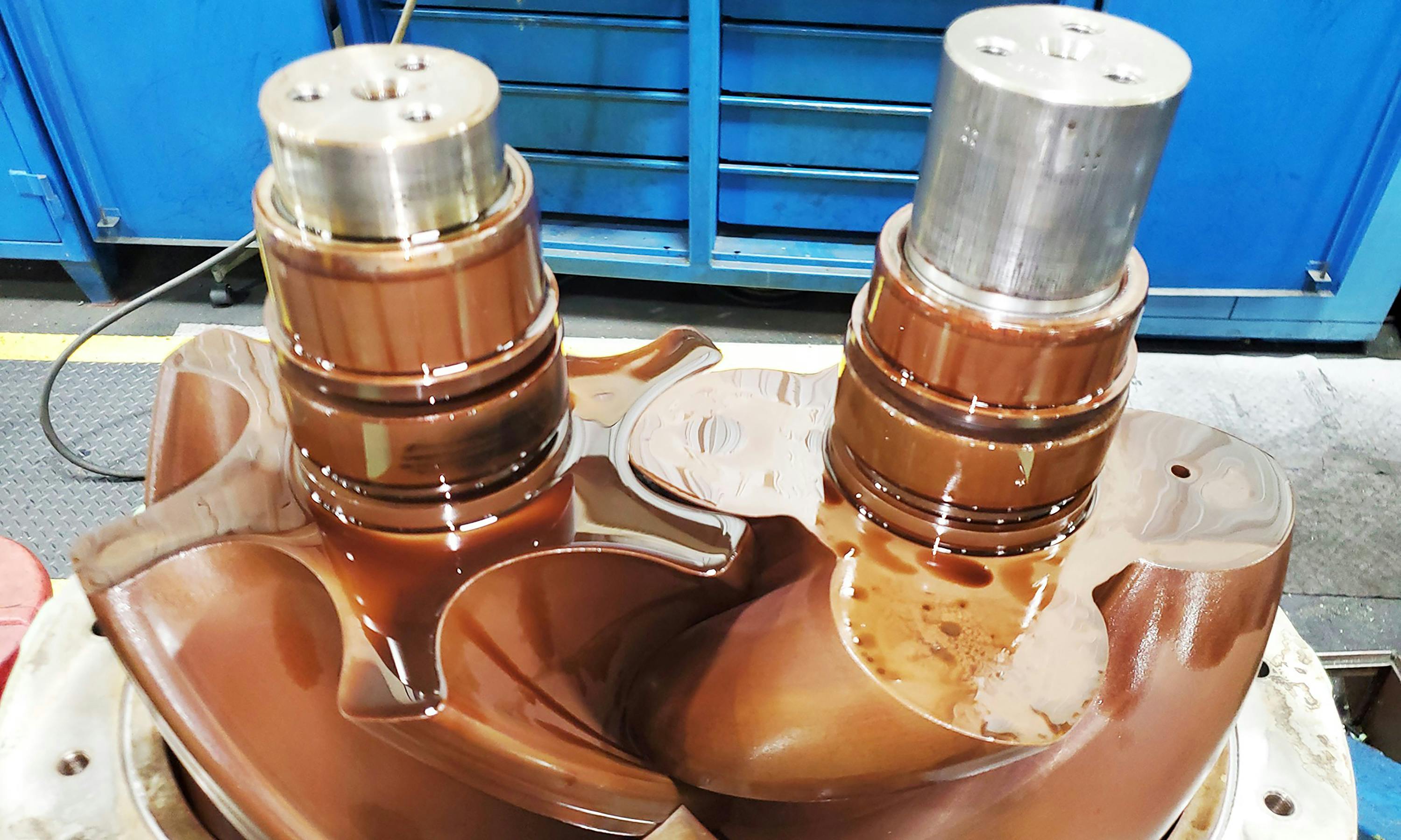

Varnish is a warning sign of fluid degradation
Low-quality generic lubricants, on the other hand, have telltale signs. An experienced technician can quickly identify the effects of a low-quality fluid, such as plaque-like varnish coating internal parts, sludge that clogs internal oil passageways, or vibrations that can be felt or heard. Varnish forms when a low-quality fluid is stressed. If fluid overheats due to an unexpected duty cycle or a hot and humid environment, the fluid begins to rapidly oxidize. The oil oxidation process forms polar insoluble solids that stick to all metal surfaces. Once varnish sets in, performance of the compressor significantly declines, and the cleanup becomes imminent and costly. Common signs of varnish include:
  • sluggish operation
  • increased bearing temperatures
  • premature air end failure
  • increased power draw.
