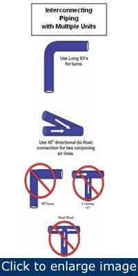

The schematic shown here reflects the basic equipment layout and design. The base load 150-hp class unit feeds a 3-in. copper header from the end and the two 75-hp class trim units come in with 90° entry to the 3-in. header from two opposing sides creating a “dead head.”

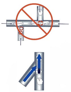

Air Power USA identified the primary problems as “…too small collector header (3 in.) combined with the high turbulence generated by the configured crossing “T” and dead head” (see current piping configuration schematic). There were other suggestions to lower air demand with air conservation projects but as long as this situation continues, the central air management system was not able to control properly as it continued to receive erratic signals and pressure spikes from the high turbulent driven backpressure. The local controllers on each unit were shocked into short cycling. The air compressor control system was not able to effectively translate less air usage into lower input kW in a timely manner.
Reconfigured piping
Air Power USA recommended a 4-in. header to replace the current 3-in. and to use directional entry to eliminate the crossing tees and dead heads (see reconfigured piping configuration schematic). Air Power USA also recommended several air saving projects — no loss condensate drains, convert open blow off lines to venturi amplifiers, convert air vibrators with electric and, most important, repair air leaks and continue to pursue an active compressed air leak detection program.

  • With a stable header and lower pressure loss, the overall discharge pressure of the compressors was lowered from 110 psig to 90 psig (20 psig, or about a 8% to 10% reduction in kW) and still delivered a stable 85 psig to the production area.
  • With a stable header pressure, the central compressed air management system was able to do its job and keep the most efficient air compressed alignment on line considering flow, pressure, timing and individual unit characteristics.
