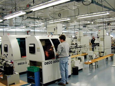

Precise air-pressure control is required to test hydraulic components machined at The Lee Company.
