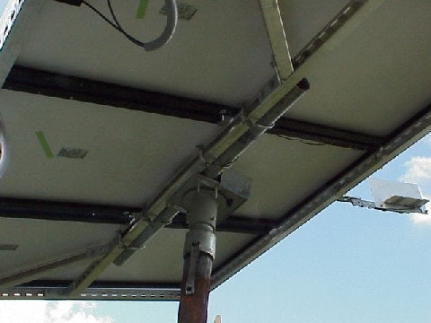

Solar panels perform as designed only when they are facing directly into the sun. A few hours later, a stationary solar panel won’t be getting direct sunlight and the output drops by 50% to 75%. You can’t reposition the solar panel every few hours at a remote site. Tracking the sun increases the output efficiency of a solar array, allowing it to produce more continuous energy relative to stationary solar panels.
The solution for this problem is a solar tracker (Figure 2). The model I use has a metal hub that rotates on a metal base, powered by a small DC motor. A 12-inch by 6-inch split solar panel with a shadow plate acts as the controller (Figure 3). The two panels are wired in opposition and one side nulls out the other when the sun faces the panels directly. Use lightweight aluminum Unistrut and pipe in lieu of steel hardware for the solar panel mounting on the tracking unit. This increases the life of the tracker because extraneous weight can wear out a small DC motor.
Figure 2: Figure 2. Sun tracker keeps the unit oriented directly into the sun.
Figure 3: Figure 3. Photocells on the sun tracker controller activate the motion.
This small solar controller keeps the larger solar array oriented toward the sun. As the sun’s position changes, one side of the controller moves into shadow, which produces enough power to drive the little DC gear motor that spins the base and repositions the solar array for direct sunlight. Later in the day, the solar tracker is facing west as the sun sets. The next morning, two small solar panels on the back side catch the sunrise and reorient the tracker to the east, when the split-panel controller takes over.
