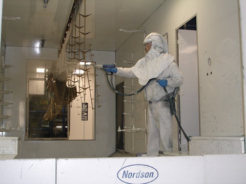

Moving from a liquid painting process to powder coating annually saves Tennant Company $33,000 per year, reducing water pollutants by nearly 36,000 pounds and cutting water use by 3.7 million gallons. Source: Tennant

“During the past three years, we moved from a typical liquid painting process in our assembly line to a powder coating system from A.B. Myr that uses less water, generates lower emissions, and decreases energy costs in the manufacturing process,” explains Kathryn Lovik, director of corporate communications, Tennant Company. “As a result, we’ve reduced our water usage by 3.7 million gallons annually, which is pretty significant for a small plant.” The conversion has generated annual savings for the company of roughly $33,000 per year and reduced water pollutants by nearly 36,000 pounds.
Water conservation is reflected in Tennant’s products as well. “Our FaST foam scrubbing technology for hard floor surfaces uses 70% less water in the cleaning process, 90% less detergent, and leaves less residue on the cleaned surface than traditional automatic floor-scrubbing methods,” says Lovik. FaST injects air into a highly concentrated chemical and water mix to create foam, generating savings in both water and wastewater costs.
