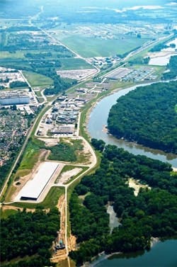

The total size of the WRA site is 4.6 million sq ft, including a conveyance system and a treatment facility. The conveyance system connects each of the participating communities in Dallas, Polk and Warren Counties to the wastewater treatment facility. The system includes 125 miles of sanitary sewer with pipe sizes up to 144 inches in diameter, equalization basins, and lift stations.
The plant, which was originally built in the 1930s, had a major expansion in the mid 1950s and then was totally rebuilt, ending in 1988. WRA employs about 100 workers and spends an annual budget of about $40 million.
