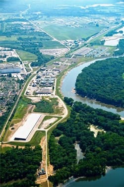

The Des Moines Metropolitan Wastewater Reclamation Authority (WRA) is made up of 17 metro area municipalities, counties and sewer districts. It serves a population of 500,000 and in 2011 treated an average of 67.6 million gal/day of sewage for an annual total of 24.7 billion gal. In the process, it created an average of 1.4 million cubic ft/day of digester biogas, an annual total of 511 million cubic ft. It applied 67,297 wet tons of biosolids on 1,721 acres, and consumed an average of 79,900 kWh of electricity per day for a total of 29,200 MW hours annually.
[pullquote]
The total size of the WRA site is 4.6 million sq ft, including a conveyance system and a treatment facility. The conveyance system connects each of the participating communities in Dallas, Polk and Warren Counties to the wastewater treatment facility. The system includes 125 miles of sanitary sewer with pipe sizes up to 144 inches in diameter, equalization basins, and lift stations.
The plant, which was originally built in the 1930s, had a major expansion in the mid 1950s and then was totally rebuilt, ending in 1988. WRA employs about 100 workers and spends an annual budget of about $40 million.
