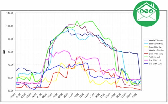

Figure 2. Set up energy logging equipment to measure overall level and quality of consumption and then trace when energy is consumed.
Log power at the main and secondary panels and at major loads. Record kW, kWh, and power factor over a representative period of time.
This provides a very accurate picture of the real power consumption on three-phase circuits and loads.
The biggest power savings come from determining when power usage peaks, evaluating power factor and overall power consumption compared to utility invoices, and possibly rebalancing loads. Even just a couple minutes of peak usage can increase the utility rate for a couple hours, days, or weeks.
Rescheduling loads may allow a company to take advantage of times of day when power is cheaper. Check how far below “1” the power factor is, and check the utility invoices to see if there’s a penalty for poor power factor. If there is, the power logger can help to trace the sources. Then, after you’ve made energy upgrades, reconnect the logger to prove out the benefit of your efficiency improvements.

The goal is to map the energy use of specific equipment and processes to look at where energy is being wasted to quantify the waste and prioritize improvements or replacements based on life of the equipment and which modifications can deliver the best return on investment.
Energy mapping also provides a baseline from which to measure the effectiveness of energy saving projects to justify the cost (Figure 3).
Figure 3. Energy mapping provides a baseline from which to measure the effectiveness of energy saving projects to justify the cost.
