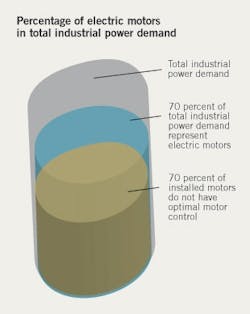

Figure 3. Electric motors represent almost 70% of the total industrial power demand, according to a Siemens internal study.
While electric motors represent almost 70% of the total industrial power demand, just about 70% of the installed motors today do not use optimal motor control, according to a Siemens internal study entitled, "Siemens Financial Services Study" (Figure 3).
In terms of energy, there are significant savings if the manufacturer runs the motor at speeds of less than 100%. This is what the VFD can offer. In some applications, these drives will pay for themselves in less than a year. In most cases, the payback is around two years or less.
One argument against installing energy-efficient motor controls is often that these systems are more expensive. The problem with this common argument is most costs associated with large electric motors are in the energy they use over their lives, rather than in their initial costs and installation expenses.
