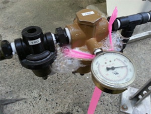

Relief valves should be tested as any other steam valve or steam trap (Figure 1). First see if any leakage is occurring at the downstream vent line. Listen to the relief valve and determine if leakage across the seat has occurred. Look for visual signs of leakage, such as condensing at the drip pan.
Figure 1. The large gasket leak in this steam pressure reducing valve (PRV) started off as an extremely small leak that was first identified months in advance with ultrasound.

Figure 2. The gasket leak of this natural gas valve, feeding a steam unit heater, was identified with ultrasound. Soapy water was sprayed on it to show the leak site was at a dried out and cracked gasket.
