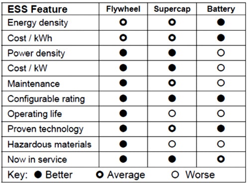

Across the spectrum, energy recycling can reduce energy use. Studies from the U.S. Department of Energy (DOE)and Environmental Protection Agency (EPA) indicate that energy recycling could meet up to 40 percent of U.S. electricity needs with as much as one-third of that (65,000MW) coming from recovery of waste energy using such technologies as kinetic energy storage. Other storage technologies such as super-capacitors, also referred to as ultracapacitors, and batteries also offer advantages; however, as Figure 1 shows, flywheels can offer greater overall benefits.
Figure 1. Energy Storage Comparison. (Source: Turner Engineering Company, 2005)
