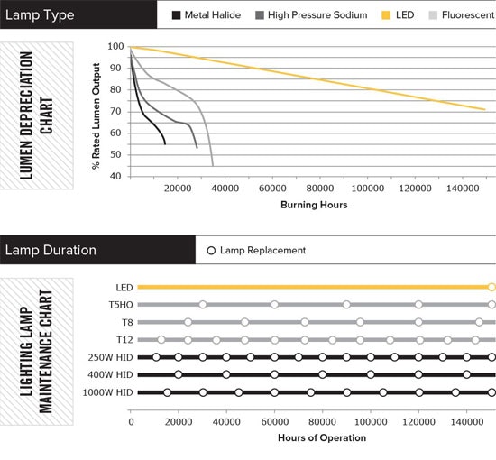

Companies concerned primarily with maintenance reduction should consider choosing LED fixtures, which have the highest upfront cost but which require the least maintenance of the three common types of lighting. LEDs don’t use bulbs and have a typical rated life of 100,000 to 150,000 hours. By comparison, metal halide bulbs last only about 15,000 hours, and fluorescent tubes last about 35,000 hours on average.

Facilities can most easily reach recommended foot candle levels with LEDs and metal halides. However, metal halides typically dim to half their original brightness within two years, whereas LEDs maintain about 70 percent of their brightness for up to 17 years of 24-hour use. Because metal halide lumen loss occurs steadily, it can be difficult to notice that foot candles have fallen below recommended levels. Regular testing is recommended.
