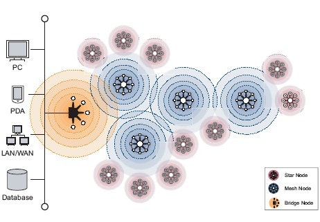

Transmission range. Peer-to-peer approaches can be used as part of a mesh architecture, where each device is capable of sending and receiving from every other device. Hence, each device doesn’t need a range of thousands of feet, it only needs to be able to communicate with its nearest neighbor, which will in turn relay the message to its nearest neighbor, etc. However, this requires sensors to be turned on more frequently, thus requiring more power.

“For this reason, we aren’t yet seeing wireless sensors that completely eliminate the need for wires everywhere in the system. Instead, we are seeing architectures that selectively employ wireless in certain parts of the system. In our case, that typically means wires between the sensors and some type of data concentrator or storage device, and then wireless from the storage device back to a host computer that acts as the HMI of the system. Most often, wireless Ethernet is used for this.
“By strategically placing data concentrators in the plant, a balance can be struck between the cost of wiring and the cost of data concentrators. And, because multiple points feed into a single data concentrator, you can fit each data concentrator with things like higher-powered antennas to increase transmission distances. So in essence, wireless does have a role in eliminating part of the wires in a system, but not all of the wires. At least not yet.”
