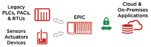

Figure 2: Industrial edge computing devices like edge programmable industrial controllers (EPICs) simplify connectivity so that plant floor data can move seamlessly through the organization.

Applied to automation networks, edge computing places more connectivity and processing power on the plant floor, which can be used to facilitate integration so that moving data across the organization no longer requires a deep technology hierarchy. With embedded support for multiple OT and IT protocols, industrial edge computing devices can process data from sensors and transmitters on the plant floor, then send it directly to on-premises or cloud-based applications and databases without intermediary hardware or software (Figure 2).

Many edge computing offerings are appearing in the industrial automation space, most commonly in the form of edge I/O and communication gateways. These provide a variety of methods for connecting devices and equipment, including traditional wired sensors, to form unified data networks. Edge programmable industrial controllers (EPICs) are a more powerful option that combines the real-time control and I/O sensing capabilities of PLCs/PACs with a broad array of connectivity tools.
Industrial edge devices provide the basic connectivity and data processing needed to establish a communications backbone within automation networks and between OT and IT systems. They combine essential communication interfaces, protocols, and applications in a single connectivity layer available to the local process, rather than spread across multiple layers of costly middleware.
