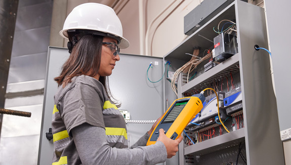

If something does go wrong, the good news is that there are plenty of simple, inexpensive tools that can help your operations technology (OT) staff identify and locate the problem.

While the certification tester used by your installer for initial testing will conduct wiremap testing, few OT departments own these complex, expensive tools. Fortunately, verification testing using a simple, low-cost wiremap tool is an ideal solution.
Identifying the actual location of a fault along a length of copper cable can be easily achieved with an inexpensive tone and probe, which works by injecting a high harmonic signal onto a conductor that generates an audible noise at the fault location. Somewhat more sophisticated verification tools include a Time Domain Reflectometer (TDR), which indicates the distance to a cabling fault, greatly reducing troubleshooting time.

If you’re dealing with fiber, one tool to have on hand is a basic fiber inspection camera that can easily reveal a dirty fiber endface at a connection point. If dirt is visible and your OT team has the skillset, it’s time to clean the connector endface using wipes and solvents. Ideally, any solvent used to clean the connector should be formulated specifically for fiber, so it makes sense to have a fiber optical cleaning kit in your arsenal.
There is also a chance that the fiber is bent or broken somewhere along the link. A simple visual fault locator (VFL) will illuminate a fiber with a visible laser that will “leak” out where the fiber is broken or bent. However, a VFL only works well if you can visually inspect the entire fiber run – not so great if the fiber is difficult to access or goes through protective conduit.
For just a little more money, it may make sense to invest in a more sophisticated fault locator that bridges the gap between a VFL and an expensive Optical Time Domain Reflectometer (OTDR), which is a more complex troubleshooting tool that requires more skill to operate. For example, there are fault locators available that locally display the location of events such as severe bends, high-loss splices, breaks, and dirty connectors that can impact transmission.
