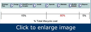

Effective lifecycle costing: The true cost to an organization of any asset is spread over the entire lifecycle, not just its initial purchase price. In most cases, much of the total lifecycle cost stems from asset operations and maintenance, for example, about 80% for facility assets. However, this isn’t the general perception, as indicated by the timeline scale used in the accompanying figure. Thus, when replacing an asset, the focus should be on selecting an asset and vendor that minimizes the total cost of ownership, not just the purchase price.
Contrary to general perception, most of an asset’s lifecycle cost (80%) stems from operations and maintenance.
