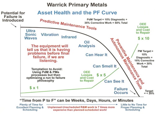

We also found that many plant management teams fail to appreciate the power of using the PF curve (see Figure 3).  This curve illustrates the power of finding early anomalies high on the PF curve, and performing early corrective, planned-kitted-scheduled R&M before final failure occurs. If there are no PdM technologies in use, then there can be no PdM corrective follow up work performed. If there are no PM corrective follow up work orders, then all that remains to be performed is emergency repairs. There will be no 7X and 10X cost savings if all the work is performed as emergency R&M.
Figure 3. The PF Curve illustrates the power of early detection of anomalies.
