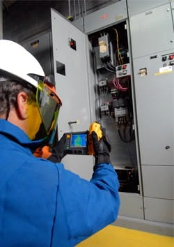

Figure 1. Insurance providers are driving compliance of infrared inspections. Source: The Snell Group
For many companies, insurance providers are driving compliance of infrared inspections (Figure 1). “Reporting on this varies with the provider,” remarks Huff. “In some cases, simply a hard-bound copy of the results of the required annual infrared inspection is all that is needed. But in most situations, there needs to be some method of verification that repairs were successfully completed. That requirement may be supported by a facility’s CMMS program or an information management solution that integrates the results of the condition-based monitoring program.”
