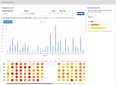

Figure 1. By tracking the number of e-stop engagements, a problem could be pinpointed to a particular shift or operator and can be addressed before damage is done to machines.

E-stops
Another often-overlooked robot data point is e-stops. Some operators misuse e-stops as a quick way to halt the process to make an adjustment or to go on a lunch break. The e-stop causes the brake to engage to a hard stop, causing undue strain on robot joints. When done repeatedly over time, it creates premature wear, leading to the need for expensive replacements.
Operators should be educated that e-stops are for emergencies only, and proper stopping procedures should be used for all other situations. By tracking the number of e-stop engagements, a problem could be pinpointed to a particular shift or operator and can be addressed before damage is done to machines.
