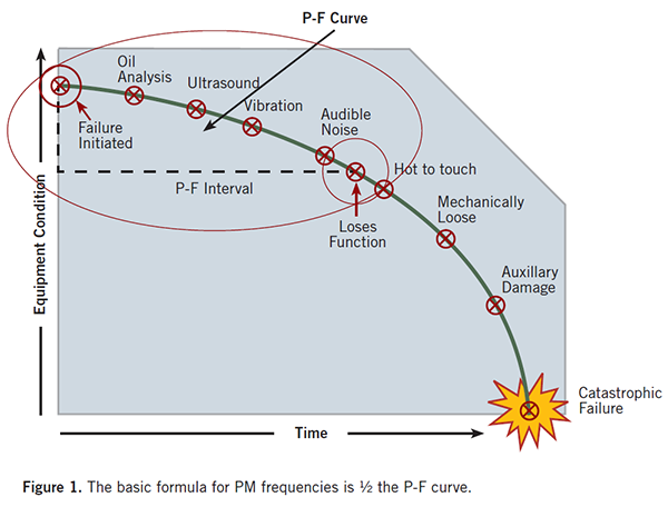

Understanding and use of the P-F curve, and understanding failures
Failures can be defined as follows:
With a potential failure, a system or equipment is operating correctly within given parameters but has a detectable failure. For example, it could be a pump bearing that reveals through ultrasound or vibration monitoring the beginnings signs of spalling. The pump is still operating within its parameters, but the failure has been detected.
A functional failure is a failure that causes the system or equipment to not meet its intended function. For example, a pump with the parameters of pumping 40 gallons per minute consistently is now pumping 39 gallons per minute consistently. This pump is not meeting its intended function but has not broken down.
In a catastrophic failure, the asset no longer functions.
Knowing this, we can begin to understand the P-F curve (see Figure 1). The basic formula for PM frequencies is ½ the PF curve: It is the difference in time between the potential failure and functional failure divided by two. For example, a pump runs from the time the failure is detected to when it has been functionally failing for 28 days. This would mean that the PM frequencies for this pump would be 28 days/2, or 14 days.
If you are doing PdM routes and have data, this would be a great method to use. The problem with this method is the many variables that go into determining the frequency of needed maintenance. The biggest one for me is, “What if the failure was never detected or detected very late?” This could change your frequency rather dramatically.
Another great solution is to go with duty cycle, number of units produced, run hours, etc., to create your frequencies. This is probably the best route to go if at all possible.
