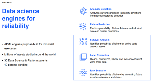

PS: I was listening closely to what you were talking about when it came to using data science engines for ingesting and cleaning data and things like label correction. How does that technology deal with text fields like notes from an operator or the last mechanic you do maintenance? Because that stuff can get buried deep in the CMMS system.
DV: Actually, that's one of the areas that we see a lot of value in. We have some methods of mining those textual fields. We can marry those textual fields with other codified fields, work order titles to establish some relationships of where we see specific words or phrases associated with specific types of work.
From there, we can either enrich the data by filling in missing context or add labels to those work orders or whatever that transactional data happens to be. Add labels such that those labels then allow us to categorize and mine that data going forward in a way that's going to be valuable.
