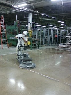

Temperature, humidity, thermal shock, equipment vibration, foot and vehicular traffic, spills, cleaning agents, and more make a plant’s floor a dynamic landscape. Some facility owners take a check-the-box approach to flooring; they simply want to pass the next inspection or fix an immediate problem. Patching problems can save money up front. But a short-term approach to industrial painting, coating, and flooring eventually spells injuries, work stoppages, or even cancelled contracts due to product contamination.

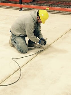

Find vendors with a passion for their craft and familiarity with your processes. They’re more likely to run a project on time and on budget. A vendor should have experience (and certifications) applying a range of industrial flooring types (e.g., epoxy with an anti-microbial coating, vinyl, polyurethane or urethane) to specific flooring surfaces. For instance, understanding the condition and chemistry of concrete affects how well a coating adheres to the applied surface. A certification means more than understanding how to apply coatings and flooring safely and successfully; credentials speak to the business’ level of professionalism.
