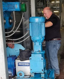

Many plants are making the move from reactive to preventive and predictive maintenance strategies. Because of this, sensors added to or included in equipment provide a wealth of information about the asset’s health. While this automatic data is welcome and needed, not all machines have sensors. Many assets lower on the hierarchy will never be equipped with sensors. For this reason, teams must continue to rely on their senses.
Figure 2. A technician examines a pump system at a wastewater treatment plant.
Plant personnel who have worked in a facility for years know how operations typically sound (see Figure 2). When something sounds different, they may notice. Machines talk. The plant team just needs to learn the language. When they tune their ears to focus on the equipment, they may hear problems such as:

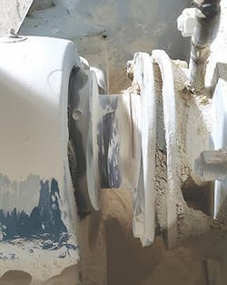

Figure 3. Gypsum visibly leaks at a drywall manufacturing plant.
As technology continues to evolve, some personnel may find themselves focused on a screen displaying the output of a sensor or multiple sensors. While observing this screen, they may miss an issue with one part of the system. Plant teams must remember that they are looking at a system of machine components that operate together to perform a desired process function and must also observe the whole system (see Figure 3).
In most circumstances, a sensor is attached to one component via one point. While a sensor may provide higher sensitivity than human senses, it may also be limited by the location and direction of the data it provides. With the exception of using multiple sensors to collect data that builds a model of the machine system, the advantage of observing the whole system goes to the human.
