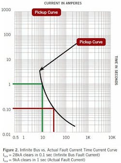

  • The short-circuit current is assumed.
  • The protective device clearing time is assumed.
Also, maintenance of the protective devices is not considered when the tables are used. This can affect the incident energy in the event that a sticky breaker or another protective device is not opening when it should, so the clearing time of the device would be inaccurate. It is also important to note that the tables and the arc flash calculations are not intended to work together. This is why NFPA 70E did away with the PPE values and identifies PPE with actual incident energy values for the analysis.
