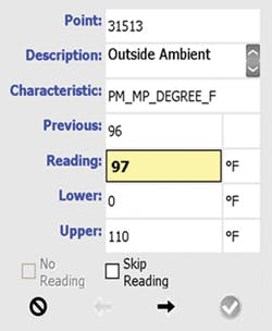

Power generation, transmission, and distribution operations are prime candidates for mobile technology. NorthWestern Energy inherited a mobile solution during a 2014 acquisition of 11 hydroelectric facilities and associated assets in Montana with a net aggregate generation capacity of 633 MW.
“Our hydro plant operators use the mobile solution for daily, weekly, and monthly safety, security, and operational inspections,” says Amber Osterman, business analyst at NorthWestern Energy’s business technology department. “Over a month’s time period, we gather about 15,500-plus reading documents. That is about 500-plus readings per day for 11 plants.”
The handheld devices contain client software that synchronizes with NorthWestern Energy’s enterprise asset management (EAM) system. “The operators pick their inspection list for the day, walk through their routes with the device in hand, and check off their inspection points,” explains Osterman. “The tasks are presented in the order that they do their rounds.” She adds: “It’s a disconnected device, so when they’re finished with their rounds, they dock their device via a USB port, and the data is transmitted.”
