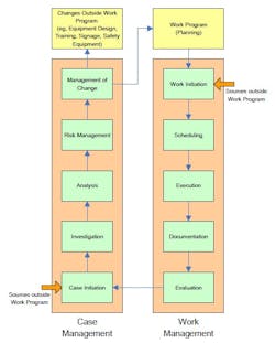

For example, the last bullet above is an ideal candidate for building a business case: A case management system can be used to record and carefully manage the process for addressing each audit deficiency. What activities are included in this? Initiating and assigning a case and launching an investigation are the first steps, of course, but the process also includes conducting root-cause analysis, assessing risks, determining costs and benefits of alternative solutions, running alternatives through a management-of-change process, and implementing approved changes. These are the formal steps within the case management flow as shown in Exhibit 1.

Asset managers today are faced with risk levels on the rise like never before because of increasing asset complexity and cost, senior management pressure to reduce costs, and regulatory compliance obligations. To help mitigate the risk and manage stakeholder expectations, a business case should be established to integrate work management and case management in terms of processes and a supporting CMMS. Benefits will flow from two major categories: productivity improvements and the opportunity cost associated with risk reduction. In addition, maintainers and others can initiate cases to investigate improvement ideas, such as changes to PM frequencies, job plan steps, safety procedures, parts and tools used, and operator/maintainer training.
