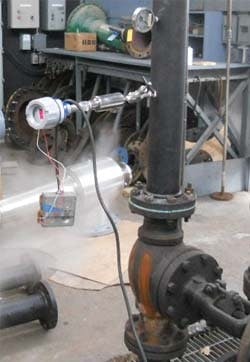

Steam quality measurement instruments
Source: Croll Reynolds
As a way to help customers ensure that high-quality steam enters its high-vacuum steam ejectors, Croll Reynolds developed a calorimeter to measure the moisture content and motive steam required to operate the high-vacuum ejector systems.
"A small portion of the steam to be sampled enters the calorimeter body through a sampling tube, which is installed directly in the steam header," says Philip Reynolds, P.E., vice president of Croll Reynolds. The steam sample passes through the sampling tube, is throttled through an orifice at constant enthalpy, and then passes into an expansion chamber. With the operator now knowing the header steam pressure and the temperature, he can refer to the moisture table provided with each unit and plot the moisture content. The sampled steam then passes through the calorimeter discharge port into the atmosphere.
"The calorimeter body can be installed on any size header," says Reynolds. "It is then connected to the sampling tube, and the globe valve is then turned to the open position." After the moisture reading has been taken, the calorimeter body can be disconnected from the sample tube and reinstalled on other headers.
For best performance, Reynolds says that the calorimeter should be installed in a vertical piece of pipe with the flow upward. "However, it can be used in horizontal pipe if necessary," he says.
