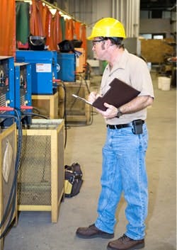

Figure 1. A maintenance audit starts with a visual evaluation of how the equipment is running, monitoring that equipment constantly throughout a work day, and recording how efficiently it is operating.

The second step is to conduct a maintenance audit. The audit permits companies to evaluate the effectiveness of their current efforts against a world-class maintenance standard. The audit starts with a visual evaluation of how the equipment is running, monitoring that equipment constantly throughout a work day, and recording how efficiently it is operating (Figure 1). It’s often only necessary to monitor the equipment for a few hours to get a good sense of how well it is working and where potential issues can be found, both in terms of short- and long-term operations. The evaluation should also assess the maintenance organization against a world-class standard, to allow the organization to see where it is functioning well and where it needs to improve. The audit can be conducted either by in-house maintenance managers or experienced consultants who are experts on the maintenance process.
