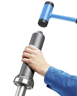

  • Whenever mounting a bearing, its rings, cages, and rolling elements or seals should never receive direct blows and the mounting force must never be directed through the rolling elements (Figure 1).
Figure 1. A fitting tool can be used for mounting of bearings to minimize risk of damage. This consists of sleeve, impact ring, and dead-blow hammer enabling effective transmission of mounting force.

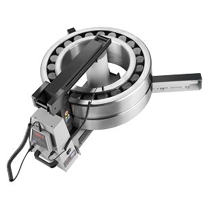

  • Select the proper mounting method for the job. The primary methods for proper mounting of a bearing are commonly referenced as “cold” or “hot,” consistent with their enabling technologies. Cold mounting, or mechanical mounting, generally is recommended for small- and medium-sized bearings, with outside diameters up to 4 in.; methods involving heat mounting will be appropriate for relatively larger bearings; and hydraulic techniques should be considered when mounting especially large bearings. Tools have been developed to accommodate each particular method (Figure 2).
Figure 2. Use an induction heater for pre-heating bearings before mounting to allow for expansion and easier installation.
