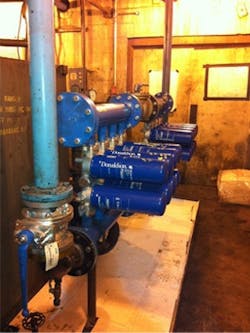

Off-line filtration
Developments in bulk filtration systems allow filtering of new oils and lubricants to meet OEM specifications for cleanliness levels. But these systems are also proving to be beneficial in upgrading industrial filtration applications.
Take the example of a mine located in northeastern section of Minnesota known as the Iron Range. The existing filtration system, installed decades ago, is used to clean the trunnion bearing lubrication oil as it gets circulated through the reservoir. The trunnion bearings support the ball mills used to grind the ore. It’s a critical application that can also be severe, given the conditions.
Upgrading the existing system was actually driven by the opportunity to address safety concerns. Changing the original system’s filters required two operators removing a very heavy lid and one climbing a ladder and tying off to reach in and pull out and replace each filter element. This also required the draining of the housing, losing hundreds of gallons of expensive lubrication oil.
The mine chose to a new system from the Clean Fuel & Lubricant Solutions division at Donaldson (www.donaldson.com), which takes up less space, and the filters are easier to change for just one operator, taking less time while mitigating safety concerns. The entire system holds less fluid, saving on lubrication oil costs, as well.
The other benefits to the upgrade include the advancements in filtration media technology. New synthetic and glass media, which had been developed since the original system went in, have improved both the efficiency and dirt-holding capacity of older systems. This means the entire trunnion-bearing lubrication system can run cleaner for longer periods of time. That cleanliness translates directly into longer life of the system components, reducing the mine’s total cost of ownership.
