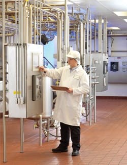

Figure 4. The control system monitors the entire production infrastructure in real-time, including WAGES consumption information, allowing the Faribault Foods team to identify opportunities for improvement.
With several hundred varieties of product going through the facility each year, it simply wasn’t designed to keep pace with the company’s growing business. In addition to producing several of its own brands, such as Butter Kernel, Kuner’s, S&W Beans, and Chilliman, the company also produces private-label brands for many large grocery retailers, and provides copacking, or contract manufacturing services as well. “We needed to demonstrate and document reliable, repeatable production practices to our customers – particularly to those working with us on copack products,” explains Hines. “Our existing production infrastructure didn’t allow the necessary level of data collection and insight; plus, it was simply less efficient to run in terms of water, air, gas, electric, and steam (WAGES) resource consumption (Figure 4).”
Once the company decided to invest in a complete facility overhaul, Hines and his team designed a comprehensive plan to identify opportunities for improvement, documentation requirements, and an ongoing timeline for implementation. “We knew this wasn’t going to be a one-time effort,” explains Hines, who, along with his team, selected a process solution based on the Rockwell Automation Integrated Architecture system, featuring eight Allen-Bradley ControlLogix programmable automation controllers (PAC). Each PAC communicates via a ControlNet network to intelligent field devices and twelve human-machine interface stations comprised of Allen-Bradley PanelView Plus terminals and industrial computers running FactoryTalk View SE software. The control system monitors the production infrastructure in real-time, including WAGES consumption information, so Hines and his team can identify opportunities for improvement quickly and document each critical step of the process. Faribault Foods implemented instrumentation from Rockwell Automation PartnerNetwork member Endress+Hauser for seamless integration with the Rockwell Automation equipment the application uses. “When we started this project, we were in the beginning stages of automating of our production system,” explains Hines. “As a result, this project represented a substantial technology change for the maintenance department. The biggest challenge was training. Every maintenance person needs to understand the functionality of the new sensing and controls devices in order to troubleshoot their operation and to be able to differentiate between control system issues and mechanical issues. We implemented a training program for all maintenance staff and specialty training for a selected group who would focus on maintaining and updating the new control systems.”
As part of the project, Faribault standardized many of the devices, says Hines. “For example, we use the same VFD model throughout the facility,” he explains. “This reduces the installation and setup time by having only one procedure. We also included electronic documentation of the location, description and function of each device and the ability to allow outside vendors to access our system through a VPN connection for data collection and troubleshooting.”
Faribault Foods won several awards for its commitment to sustainability. The solution also includes more than 60 Allen-Bradley PowerFlex variable frequency drives for more intelligent motor control throughout the plant. The drives improve equipment efficiency by adjusting cycle speeds as needed rather than running at full capacity at all times. In addition, the drives feed critical motor data back to the central control system for improved maintenance capabilities.
To ensure a smooth transition, Hines wanted to train his staff on the new technology as soon as the system was online. “Previously, one or two staff members possessed 90% of the control system knowledge,” he says. “With the new system, we wanted to make sure everyone understood how it worked.” By partnering with Rockwell Automation, Werner Electric (a local authorized Allen-Bradley distributor) and Alexandria Technical College, plant-floor staff receives training on everything from basic maintenance and troubleshooting, to servo control and the company’s latest software implementation.
The Allen-Bradley controls are running the company’s heat and energy-recovery system, which reuses 100% of the heat from the can cooling process to warm city water for the soaking, blanching, and cooking operations. The result is a 38.2% decrease in natural gas usage, which won the company Xcel Energy’s 2009 award for the largest natural gas reduction among industrial customers in the state of Minnesota. In addition, the system reuses cooled water to reduce the temperature of the cans in the cooking process, which cuts down on the company’s overall water usage by more than 100 million gal/year.

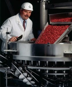

Figure 5. Tighter control of the process also allows for reduced waste in the manufacturing process.
Tighter control of the process also allows for reduced waste in the manufacturing process (Figure 5). To accommodate the cooking process, the company leaves “head space” in each can – essentially an air pocket between the can lid and the beans. Previously, at the end of the manufacturing line, the head space would be pushed out along with a few ounces of canning fluid, which would be flushed down the drain. Now, thanks to the increased process accuracy and reliability, the plant-floor team can fill to exact levels, ensuring that no fluid is wasted when the head space is forced out of the can.
