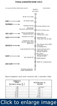

Figure 1. Typical A-weighted sound levels correlate with various activities and noise sources.
To understand what causes noise and how to minimize it, one must first understand the basics of sound. The audible frequency range falls between 20 Hz and 20,000 Hz. However, the human ear has trouble hearing frequencies much below 200 Hz or above 10,000 Hz. Although humans’ hearing frequency range might be limited, the ear can distinguish a range of pressure fluctuation from very low levels to very high levels, which gives the ear an increased sensitivity of about 10^-9 power or one billionth. Because of the large values that characterize this high sensitivity, a decibel (dB) is used to define sound levels. Figure 1 provides a table of common decibel levels and relates them to sounds with which most people are familiar.
Although the concept is helpful for understanding relative decibel levels, it can’t provide an accurate measure of the intensity of sound in an environment, which is critical to meeting regulations and industry standards. A pressure-sensitive instrument called a sound level meter captures an accurate value of sound intensity. But like the human ear, the device can be fooled and indicate the wrong level and frequency. A sound level meter outfitted with the wrong microphone or used in the presence of wind, electromagnetic fields or other interference might indicate false readings. Therefore, to capture an accurate reading, it’s important that the person operating the meter know how to use the instrument properly and be aware of the electrical and acoustical characteristics of the area being measured.
Because the sound level meter discerns frequency better than the human ear, various weighting networks or filters have been established so that the meter reading will come closer to indicating what the human ear hears using the standardized “A,” “B” and “C” weighting scales. The “A” scale is a filtering system that roughly matches the human ear’s response at sound levels below 55 dB. The “B” scale roughly matches the ear at levels between 55 dB and 85 dB, and the “C” scale is for sounds louder than 85 dB. The “A” scale (sound pressure level measured in dB “A”) has received prominence because of its use by the Occupational Safety and Health Administration (OSHA), for measuring levels to 115 dB.
