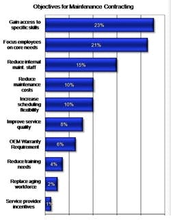

Figure 2. A new study by ARC (www.arcweb.com) shows cost reduction as fourth on the list of why companies contract for services.
ARC’s surveys indicate that the number of plants that already outsource services or are “very likely” to do so has more than doubled in recent years and now stands at 30% of manufacturing respondents. Building automation leads the list of outsourced activities in ARC’s research; at least 20% of manufacturers outsource in areas including production equipment, as well as electrical and wiring (Figure 1).
In ARC’s 2008 survey, 116 maintenance respondents in manufacturing industries indicated that “gaining access to specific skills” and “focusing employees on core needs” were the top two drivers (Figure 2).

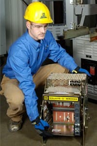

Such specialized needs are often filled by OEMS like Schneider Electric’s Square D Services (www.squared.com), which
Figure 3. Access to specialists’ skills and equipment leads the list of reasons why companies contract for services.
manages customers’ electrical switchgear and related distribution assets (Figure 3). The company’s “sweet spot” is with customers “with more in-house expertise, who are at the forefront of doing maintenance,” says Hal Theobald, Square D product marketing manager. His reasoning is, “They’re going to be more likely to outsource because they still believe in doing maintenance right,” even as the economy forces staff reductions.
