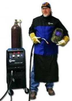

  • The well-dressed welder protects himself from all the potentially harmful effects of arc welding. Proper protection includes: safety glasses, head gear, a welding jacket, an industrial-grade helmet, welding gloves, a leather apron, denim pants without cuffs and leather shoes.
    Wear the proper gear. Neither shorts nor short-sleeved shirts belong in a welding cell. Even a quick tack weld requires the proper safety gear, including a helmet, gloves and appropriate clothing.
    Wear only flame-resistant clothing, such as denim pants and a shirt made from tightly woven material or a welding jacket. The excuse that welding jackets are too heavy, hot, restricting or cumbersome is quickly becoming a thing of the past. Makers of safety gear now produce lightweight clothing from flame-resistant cloth, pigskin leather and combinations of the two that offer better protection and increased ease of movement.
    Gloves, too, have progressed beyond the one-size-fits-all type. They are now available with ergonomically curved fingers and with different designs for specific welding processes. Heavy-duty MIG/Stick gloves, medium-duty MIG gloves and TIG gloves that provide added dexterity and touch are just some of the options available. Remember that gloves are not sufficient to pick up just-welded material. Use pliers to avoid burns.
  • Wear the right shoes. High-top leather shoes or boots provide the best foot protection. Pants legs should go over shoes. Do not wear tennis shoes or cloth shoes that can smolder, causing a burning sensation.
