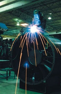

While drives certainly contribute to harmonic problems, they aren't the only causes. In fact, any equipment that converts alternating current (AC) to direct current (DC) can create harmonic distortion. This includes many of the systems used on the plant floor, such as welders, arc furnaces, process controllers, lighting systems, DC power supplies and uninterruptible power supplies.
Many industrial operations, such as electric welding, can generate harmonics.
Harmonics problems usually aren't catastrophic, but they can cause equipment overheating, erratic system operation, nuisance tripping and noise transfer to other loads. This can lead to equipment damage and production downtime. In extreme cases, utilities can impose penalties on power users or even disconnect a facility from the power grid until harmonic problems have been resolved.

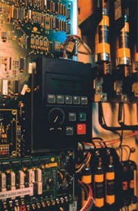

A typical plant installation may include drives alongside other electrical elements
Drives using pulse width modulation technology with the least distortion today are 12- and 18-pulse AC variable frequency drives. They produce little transient noise and can offer a total harmonic distortion of less than three percent. And with a 0.95 power factor, or better, these drives eliminate the need for power factor correction capacitors and tuned inductors.
