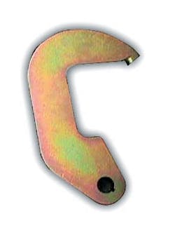

The first vehicle restraints addressed the problem effectively. When a trailer is backed up to a dock, a hook inside a wall-mounted housing rotated up to grab the rear impact guard (RIG), holding the truck in place (Figure 3). If the trailer was secure, forklift drivers saw a flashing green light. When the RIG was released, they saw a flashing red light. Truckers, meanwhile, saw a red light when the trailer restraint was engaged.
Figure 3. Introduced in the late 1990s, the “fish hook” is designed to wrap around the rig to protect against every known form of trailer separation.

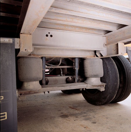

Yet new hazards emerged at the loading dock. Trailers with air-ride suspensions have a bed height that can fluctuate by several inches as lift trucks add or remove loads (Figure 5). These trailers have a natural tendency to bounce with the weight of loads and progressively move away from the dock. The bouncing can cause some restraint designs to lose their grip on the RIG.
Figure 5. Through the 1990s, vehicle restraints had to adapt to secure low-bed trailers with RIGs as low as 12 in. above ground.

It’s clear that vehicle restraints must do more than resist trailer movement straight out and away from the building. In effect, they have to trap the RIG so that it can’t move outward, rise or tip. The resulting technological advance is improved rotating hook designs, ensuring that the hook wraps around the RIG, providing two-point entrapment that protects against every form of trailer separation.
