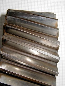

The case-hardened teeth shown in Figure 4 are from a gear in a reducer. A careful inspection of the photo shows pitting at the bottom of the dedendum, a warning of an impending disaster. The reducer was overloaded because the plant increased the operating loads without understanding the possible consequences. Fortunately, the damage was found before the reducer failed catastrophically. Don’t be like the plant managers who made this decision. When we asked them how their decision to increase production rates could affect equipment reliability, they had no ready answer.
Figure 4: Pitting at the bottom of the dedendum warns of upcoming gear failure.
