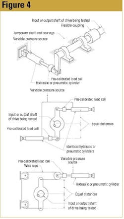

Calibration
Calibrate sensors before recording data. A typical calibration procedure mechanically locks either the input shaft or the output shaft and applies known loads to the other end of the drive while recording readings for each applied load. It’s important that sensors and drive train components experience the loads in the same manner as when the drive train is operating. This can be awkward in the case of loads that are purely torque. For example, if the gearbox output shaft is coupled to its load with a gear coupling, the load is pure torque. If the sensors are calibrated by applying known loads to the output shaft, the applied calibration loads also should be pure torque. Figure 4 shows three schemes for applying pure torque loads. Keep in mind that the locked drive also applies a load, so the locking method also must represent operational loads accurately.
