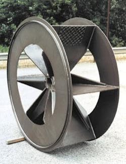

Figure 1. A 179-in.-diameter cement plant backward-curve fan undergoes a complete rehab and makeover before going back into service. Notice the wear pads that will help the wheel defy the erosion that destroyed its previous incarnation.
Repair or replace?

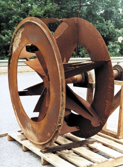

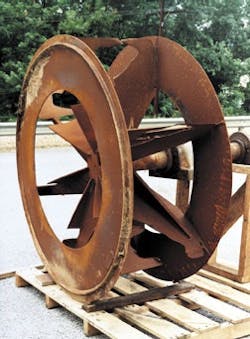

Even with the best maintenance, a fan or blower someday will need replacement or repair. Most industries prefer repair because of potential cost savings and an opportunity to have a better fan. Rebuilding , an extensive form of repair , also is an option. It may be possible to rebuild to like-new condition what appears to be a destroyed or unredeemable fan wheel. Even one whose blades have been worn through can be rebuilt, frequently with superior materials that reduce future wear (Figure 1).Rebuilding presents an opportunity for design modifications that can improve strength and efficiency. Reworking can move the fan's critical speed farther away from the operating speed to reduce vibration and sensitivity to imbalance. Reducing rotor inertia can reduce both the time needed to bring the wheel to full speed and the stress on the power train. Material thickness can be adjusted to improve resistance to cracking.Increase wear resistance
Wear occurs because the blade or blade liners aren't hard enough to resist erosion from a dirty air stream. Dozens of new alloys, steels and wear-resistant materials are available. Finding the right one for the application depends on cooperation among the plant engineer, fan engineer and the manufacturer of the metal or alloy. Chromium carbide liners, for instance, have proved to be a cost-effective means of reducing wear and extending wheel life. Blade liners, web liners, wear strips and bar liners are other options to combat erosion.Fan repair begins with an analysis that determines which variables are responsible. The fan then can be redesigned and constructed to fit the application precisely. In some cases, only the shaft and hub (and, possibly, part of the wheel) will be preserved, while the rest of the fan is rebuilt. The fan engineer has a spectrum of design options, including radial, backward inclined, airfoil, radial tip, backward curved, forward curved or axial flow blades, to address operational problems. For instance, in certain applications, backward-curved fans can resist material buildup. Backward-curved fans should not be designed with too much curvature, however, because dust can accumulate in the pockets. Backward-curved centrifugal fan designs with steeply sloped blades minimize buildup of this type.Stop corrosion
