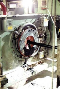

Figure 4. Pipe entering die for extrusion application of coal-tar coating. (Courtesy of Dura Bond Coating, Inc.)
Several states prohibit or discourage the use of coal tar coatings because of concerns about heath and safety. Coal tar contains polycyclic aromatic compounds, some of which are carcinogenic. When coal tar is heated for application, many of these compounds vaporize.
Being much less aromatic than coal tar, asphalt contains fewer carcinogenic compounds, but its use also is restricted in some locations. Asphalt mastics consist of a dense mixture of sand, crushed rock and fiber bound with asphalt. These mastics normally require a primer.

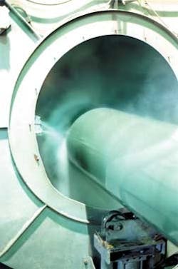

A fusion-bonded epoxy coating consists of a thermosetting powder applied electrostatically to electrically grounded metal components (see Figure 5 and 6). Heating in an oven fuses the powder into a hard, continuous, cured film. A high level of cleaning and precise application are necessary for outstanding performance.
Figure 5. Overview of powder coating chamber.
Figure 6. Applying powder coating. (Both courtesy of Dura Bond Coating, Inc.)
North America currently seems to prefer these coating systems for buried and immersed pipelines. Europe favors the three-layer, fusion-bonded epoxy-polyolefin system.
Fusion-bonded epoxy coatings may be thin and brittle one-layer systems (with good resistance to soil stresses) or two-layer thicker systems with greater resistance to mechanical damage and high temperature. These coatings also are used as primers for two coats of polyolefin. The fusion-bonded epoxy provides good adhesion to the pipe and polyolefin, as well as good resistance to mechanical and environmental degradation.
