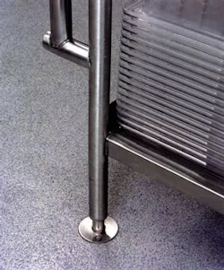

Figure 4. A close-up of acrylic reactive resin colored quartz floor,notice its textured, slip-resistant finish.

Generally, MMA-based acrylic reactive resin systems are installed resin rich and, therefore, are free of pores and voids throughout the entire thickness. This results in an impervious, waterproof finish that protects the underlying sub-floor from damage. Liquids, solids, oils and other industry-related substances cannot penetrate into the floor and are cleaned easily in a variety of ways, depending on surface texture and environment.
