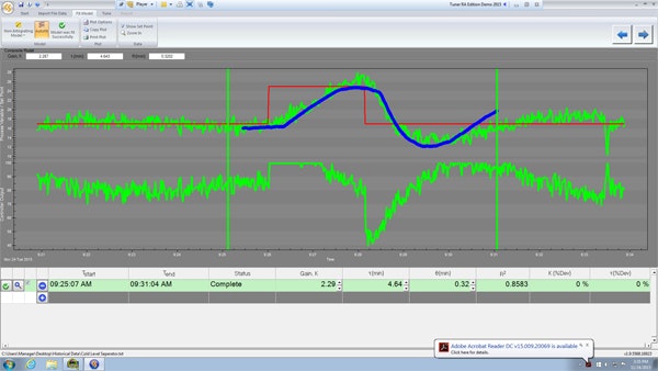

Figure 2 - CLPM technologies are among those that actively capture process changes for the purpose of modeling the associated dynamics and recommending optimal tuning parameters. The graphic above highlights the poor control from existing parameters over a 30-day period and simulates how tuning parameters recommended by the CLPM solution could have improved control.
