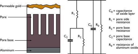

Modern aluminum oxide probes measure water vapor pressure, which is proportional to dewpoint. Overplating a thin film of gold on the oxidized surface of an anodized aluminum strip forms a capacitor (see Figure 2). Water vapor diffuses through the gold into pores in the oxide to alter its conductivity, which is proportional to water vapor pressure. A ceramic probe works the same way, but uses a ceramic substrate instead of aluminum.These probes are relatively sturdy and insensitive to dirt and debris. The initial cost is lower than the chilled mirror type. The calibration and maintenance cost may be somewhat lower. This probe offers an accurate, fast response. Saturated air won't damage them because they dry quickly, but drying time is determined by relative humidity. Continued saturation, however, leads to deterioration. Initial cost, durability, accuracy and repeatability recommend aluminum oxide and ceramic sensors for production facilities.Thin film polymerA thin film polymer sensor measures relative humidity with a capacitive polymer bonded to a temperature sensor. An onboard microprocessor converts the two readings to dewpoint.Polymer sensors have a high tolerance for corrosive chemicals and are immune to condensation. They offer long-term stability, accuracy and a fast response. Some manufacturers offer an auto-calibration feature to compensate for widely varying dewpoints and for very low dewpoints. The initial cost is in the low-to-moderate range. They're best suited for refrigerated dryer systems because their performance won't degrade in extended saturation situations. On the other hand, they have marginal accuracy in the lower pressure dewpoint ranges.Calibration

Figure 2. Schematic of an aluminum oxide probe.
