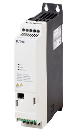

Eaton's PowerXL DE1 variable speed starter (VSS) was designed for users who have basic applications, but still require variable frequency and advanced motor protection.
Eaton's PowerXL DE1 variable speed starter (VSS) was designed for users who have basic applications, but still require variable frequency and advanced motor protection. The DE1 design is engineered to allow users to simplify their design and reduce installation time.
Features include:
  • Simple design without a keypad
  • Compact design
  • Rugged design rated up to 60 °C
  • Three indicating LEDs for fault and condition status
  • Intuitive configuration module for programming
  • DIN rail and screw mountable
  • True side-by-side installation
  • Low capacitor design for low harmonics
  • Removable I/O terminal blocks (3 digital inputs, 1 digital/analog (programmable) input, 1 relay output)
  • Contactor style power wiring
  • RS-485/Modbus as standard
